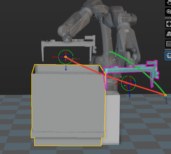

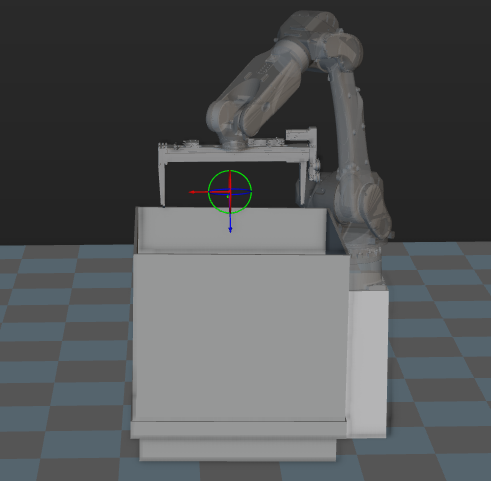

I would like to move robot from this pose

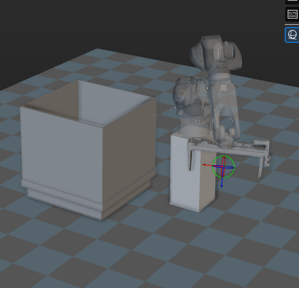

Up to this pose

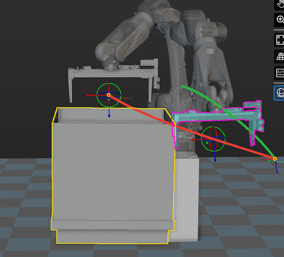

But there is a collision midway with the box and tool
It got me thinking if there might be a feature something like automatically creates additional pose to dodge scene object and then proceed to target pose.
In this current set-up i can just manualy add a fixed point in between to dodge the box. I just wanted to ask if the feature exist since the feature will be the key to the future project i am thinking of.

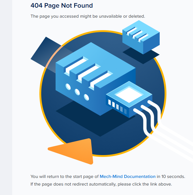

both links returns a 404 Page Not Found
Hi Carl,
The AI Assistant got the steps right but let you down on the links.
Try this link Topic: Collision Detection
