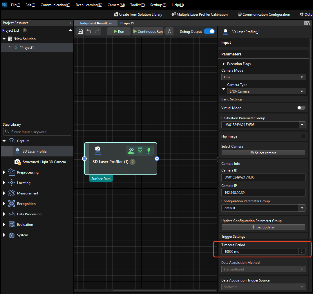

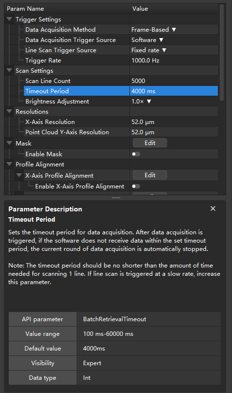

① BatchRetrievalTimeout (Set in Mech-Eye Viewer)
You can set this parameter in Mech-Eye Viewer to define the maximum waiting time for each line scan.
Failure to complete a line scan within the timeout period triggers timeout warning or ends the current round of data acquisition.
(As shown below)
