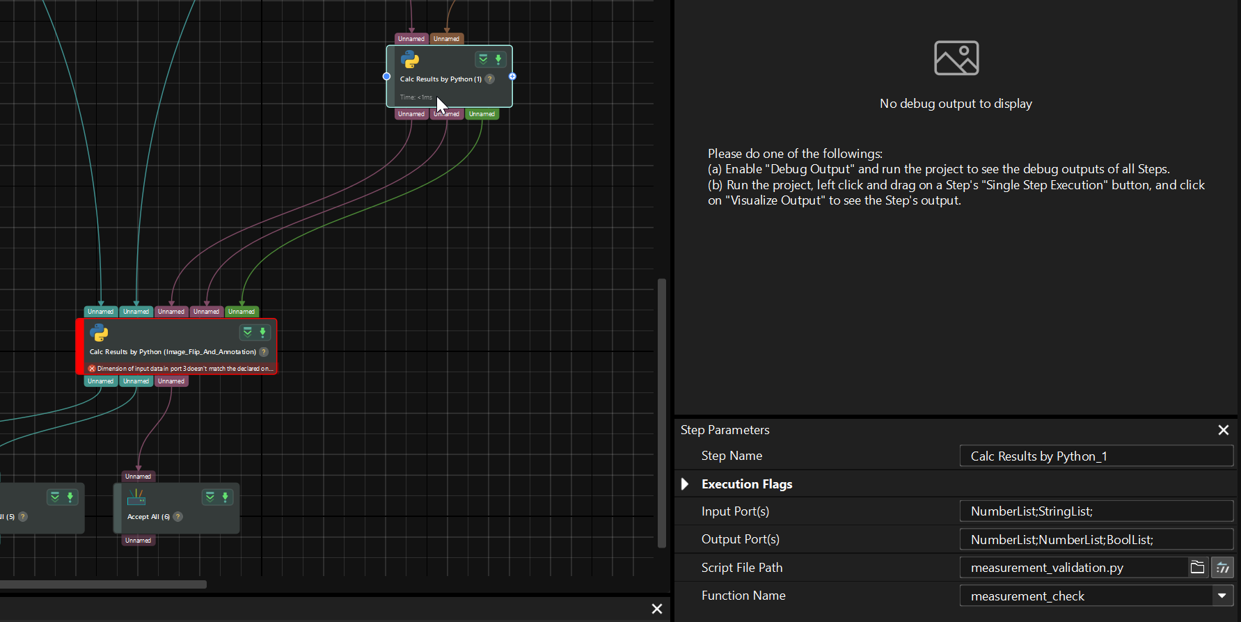

I am using the following:
- Mech-Vision 2.1.2
- Calc Results by Python

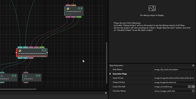

Shown in the images below is the section of my program where I am using one Calc Results by Python step to output NumberList;NumberList;BoolList to another Calc Results by Python inputs of Image;Image;NumberList;NumberList;BoolList (as shown below):

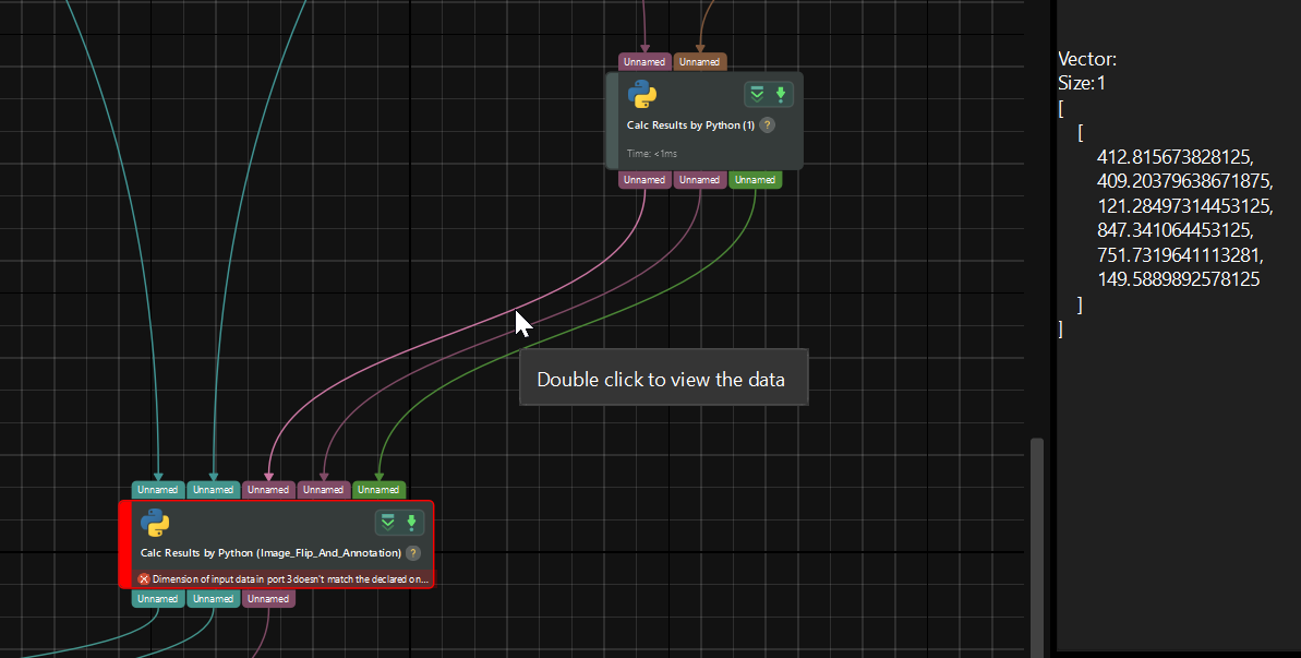

Sample of the data being passed:

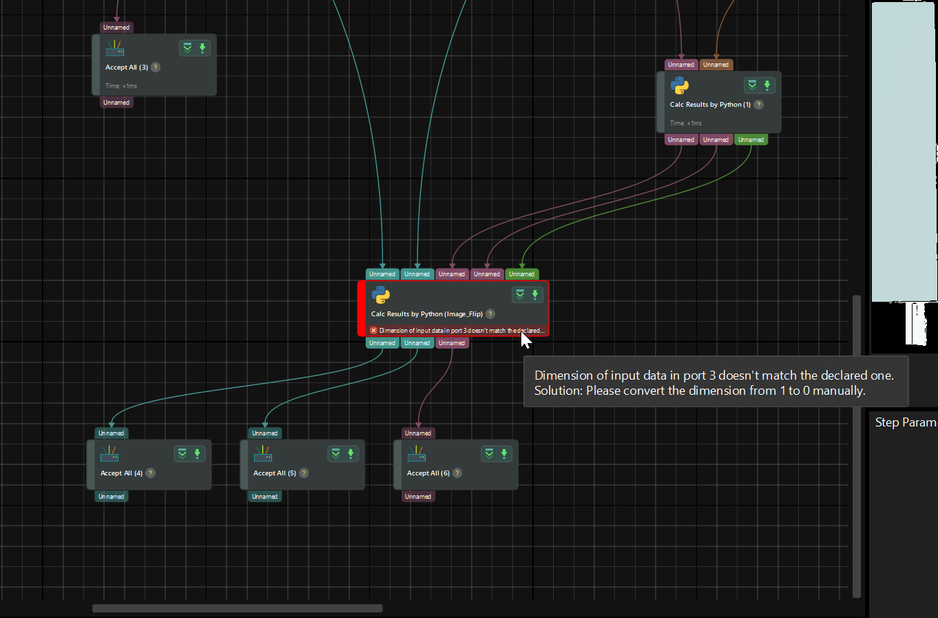

When I do that, Mech-Vision throws the error shown below:
NOTE: The python steps called “Image_Flip” and “Image_Flip_And_Annotation” are the same step, I just changed the name between taking the screenshots.
My question is:
- How do I convert the dimension from 1 to 0 manually?
