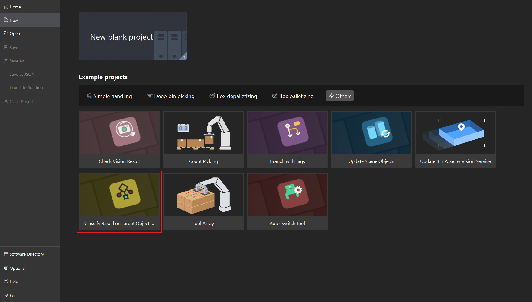

No, the filtering is done in Mech-Viz, so in the Mech-Vision project, it’s only necessary to output all the results. The filtering of the desired content and execution of different plans will be handled through the “Classify” function in Mech-Viz.
Please check out this example project.
