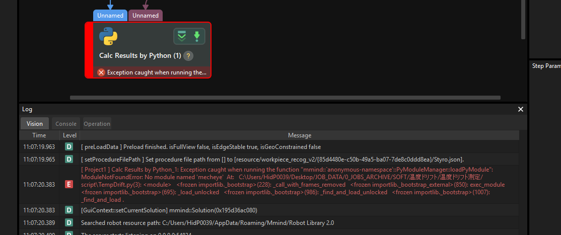

I am trying to get the temperature of the camera and recognized pose in 1 document.
Using Mech Vision i did object recognition and give the resulting pose to Calc Results by Python step for data saving.
Inside the Python script, I am also integrating the MechEyeAPI module to get the camera temperature.
and writing them to a document together with the pose. If i run the python script alone it can properly retrieve the camera temperatures.
My problem is I have these errors in mech vision
It does not seem to recognize the MechEyeAPI module even though i already did the pip install of MechEyeAPI in MechVision’s python directory.
PS C:\Mech-Mind\Mech-Vision & Mech-Viz-2.2.1\Mech-Vision\python> pip install MechEyeAPI
Requirement already satisfied: MechEyeAPI in C:\Users\HidP0039\AppData\Local\Python\pythoncore-3.14-64\Lib\site-packages (1.5.8.2.1.0)
Requirement already satisfied: numpy in C:\Users\HidP0039\AppData\Local\Python\pythoncore-3.14-64\Lib\site-packages (from MechEyeAPI) (2.4.4)
What is the solution for this error?

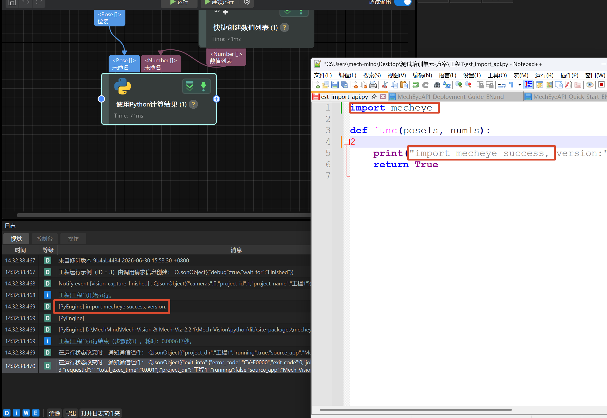

Cd C:\Mech-Mind\Mech-Vision & Mech-Viz-2.2.1\Mech-Vision\python, and type “.\python.exe -m pip install MechEyeAPI”.
“pip install MechEyeAPI” would install the MechEyeAPI to your default Python, not the Vision Python

I have asked AI, here is the reply: " the MechEyeAPI version MUST be 2.5.4. Other versions (e.g. 2.6.0) will fail inside Mech-Vision, so install (this exact version only) "
type “.\python.exe -m pip install MechEyeAPI==2.5.4”, and restart the Mech-Vision software, I have import mecheye correctly.
Thank you, This Solved it
