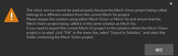

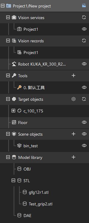

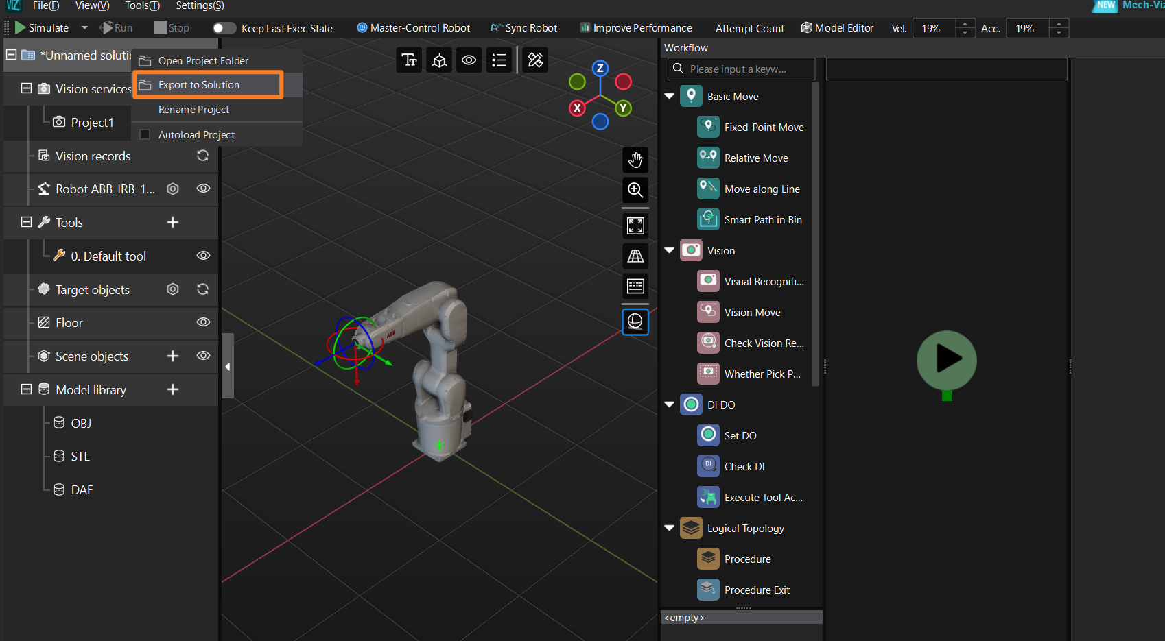

Hello, I have created projects in Mech-Viz and Mech-Vision (photos 1 and 2), I am trying to run a simulation in Viz to see the trajectory of the robot, and an error pops up (photo 3). This happens if I try to move the robot in vision service mode.

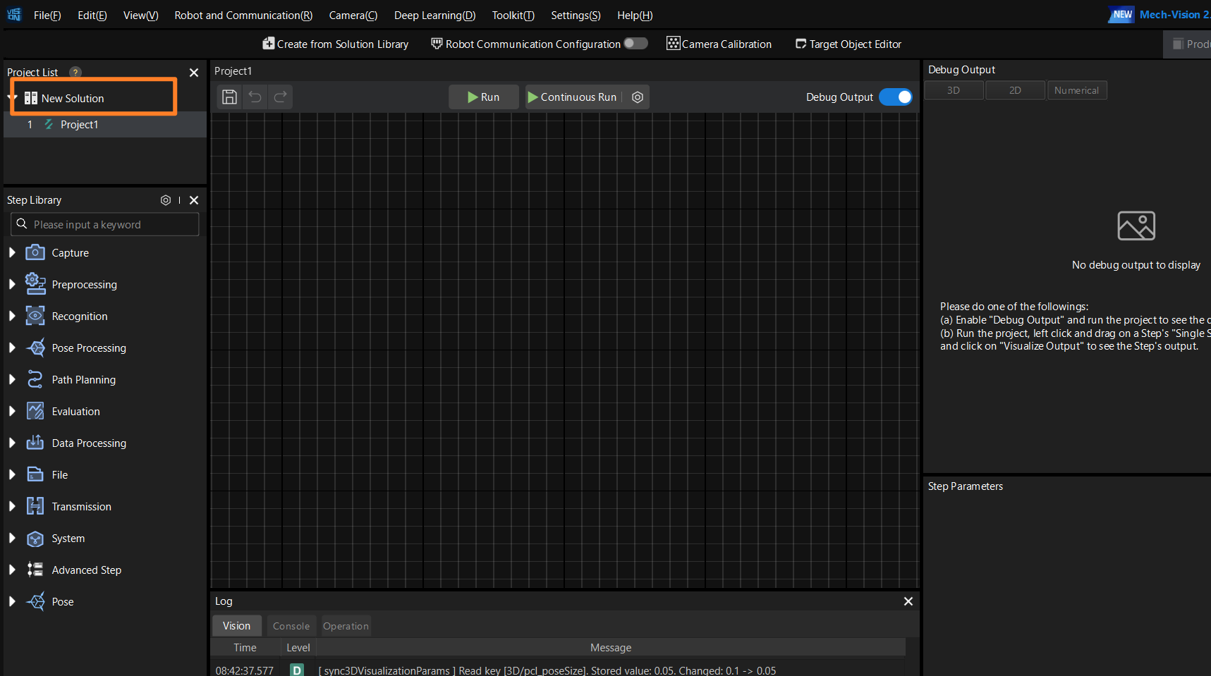

I see this situation in the project tree (photo 4)
