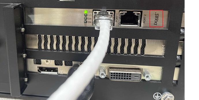

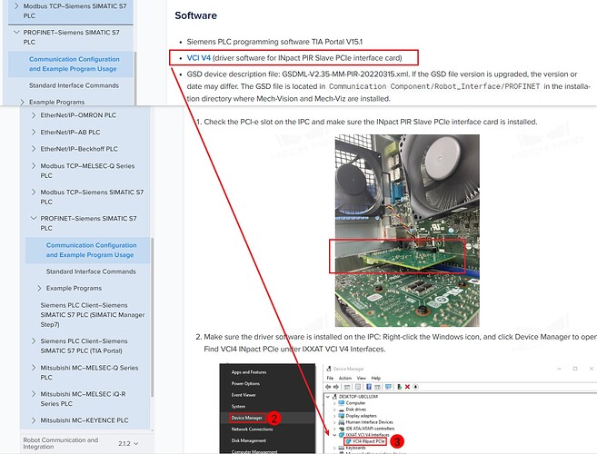

Experts and friends, please tell me how to check if the PCIe INpact PIR Slave interface card is mounted on the IPC IPCW-i5-16G-512G-1660s-EU, I have mounted the IPC in another area so it is not convenient to remove it. Is there any way to check on the software, thank you. I am waiting for feedback from experts and friends
There are the following two methods.
- Hardware–

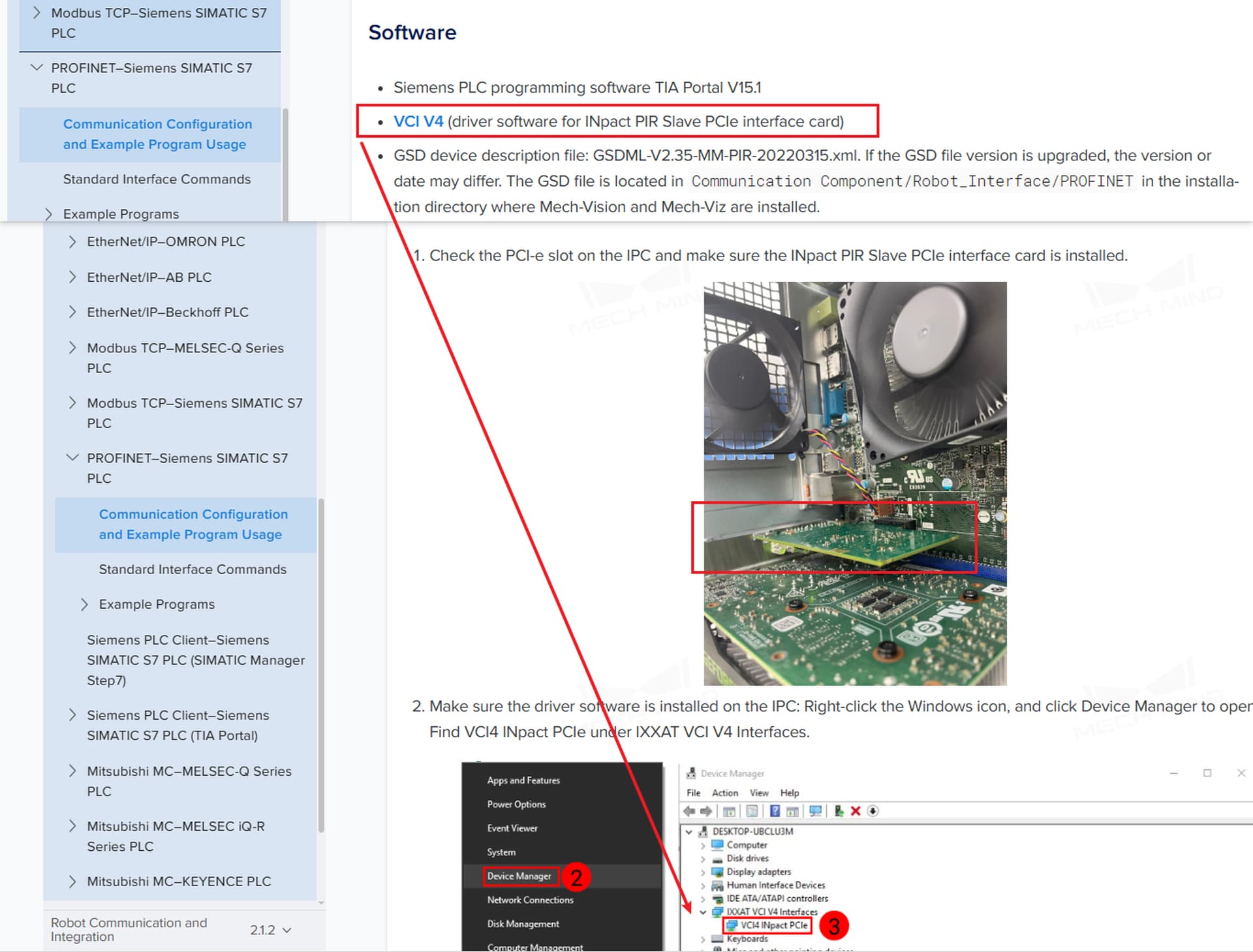

- Software–
Communication Configuration and Example Program Usage
