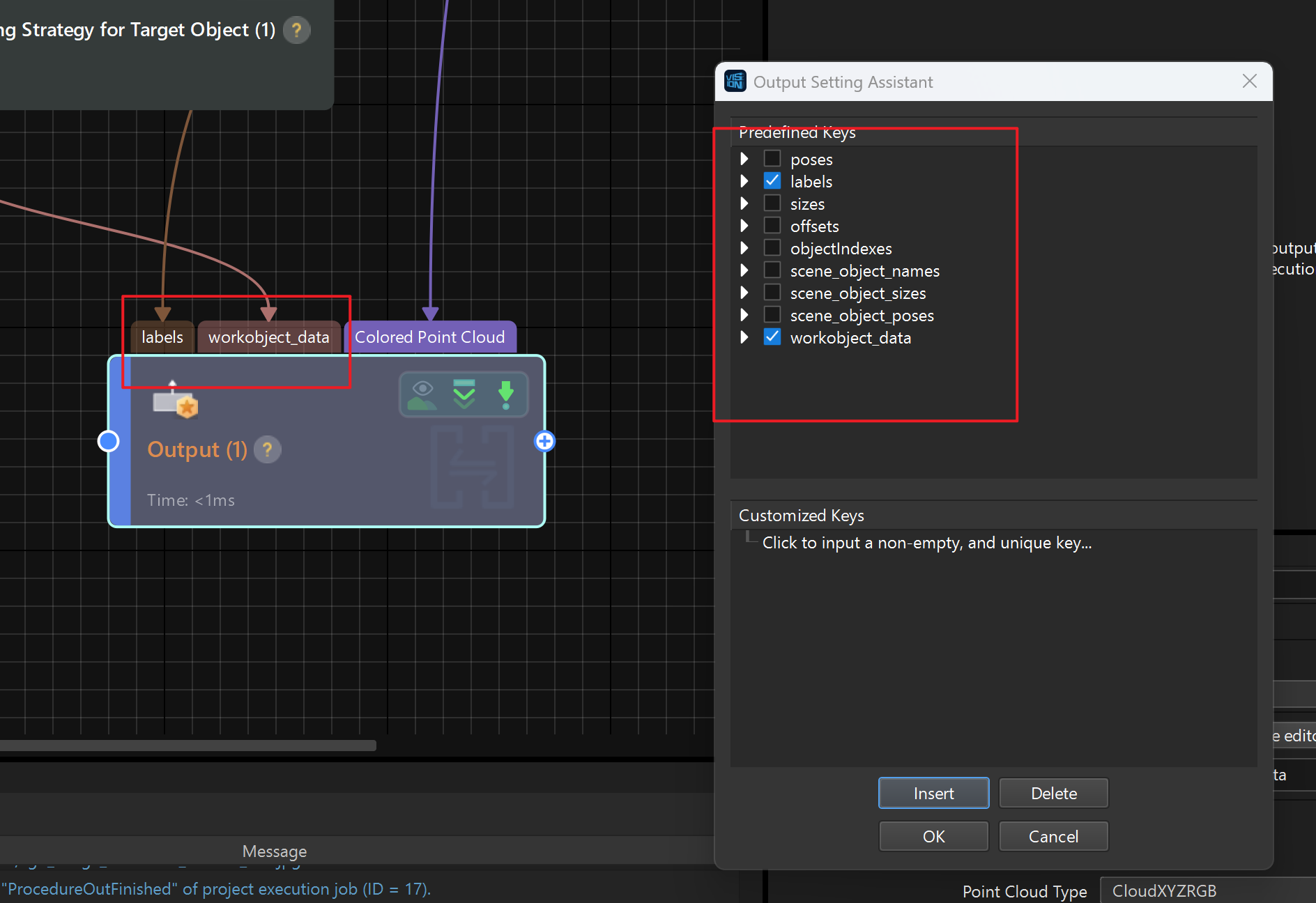

In Mech-Vision, open the Output step.
Tick “Enable WorkObject data in output”.
Under “Labels to send out”, check the labels you actually need (usually “pose”, “id”, etc.).

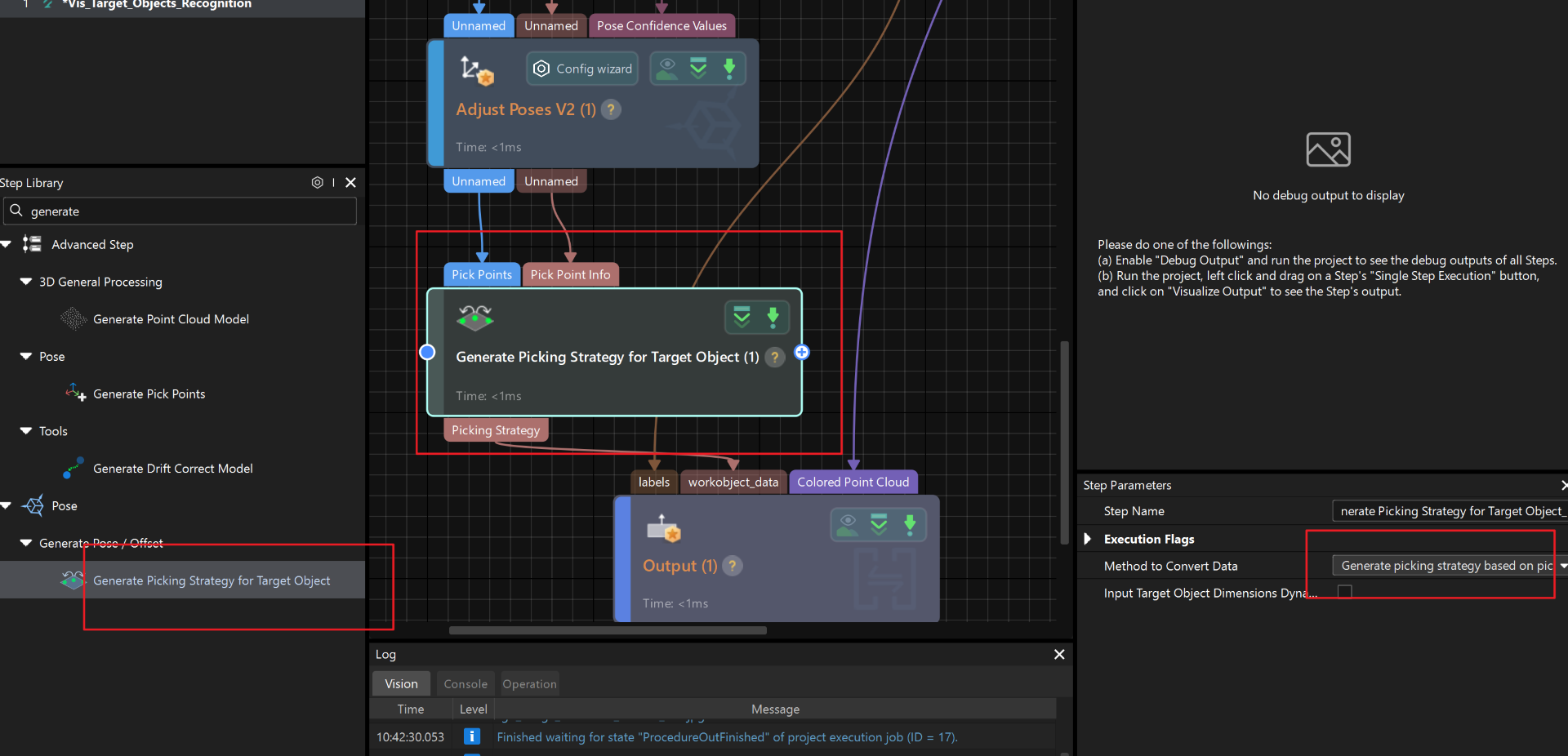

Add the step “Generate Picking Strategy for Target Object”.
• Inside this step, set “Select based on picking point”.
Draw a connection from the “Generate Picking Strategy” step to the “WorkObject_data” port of the Output step.
Save and redeploy.

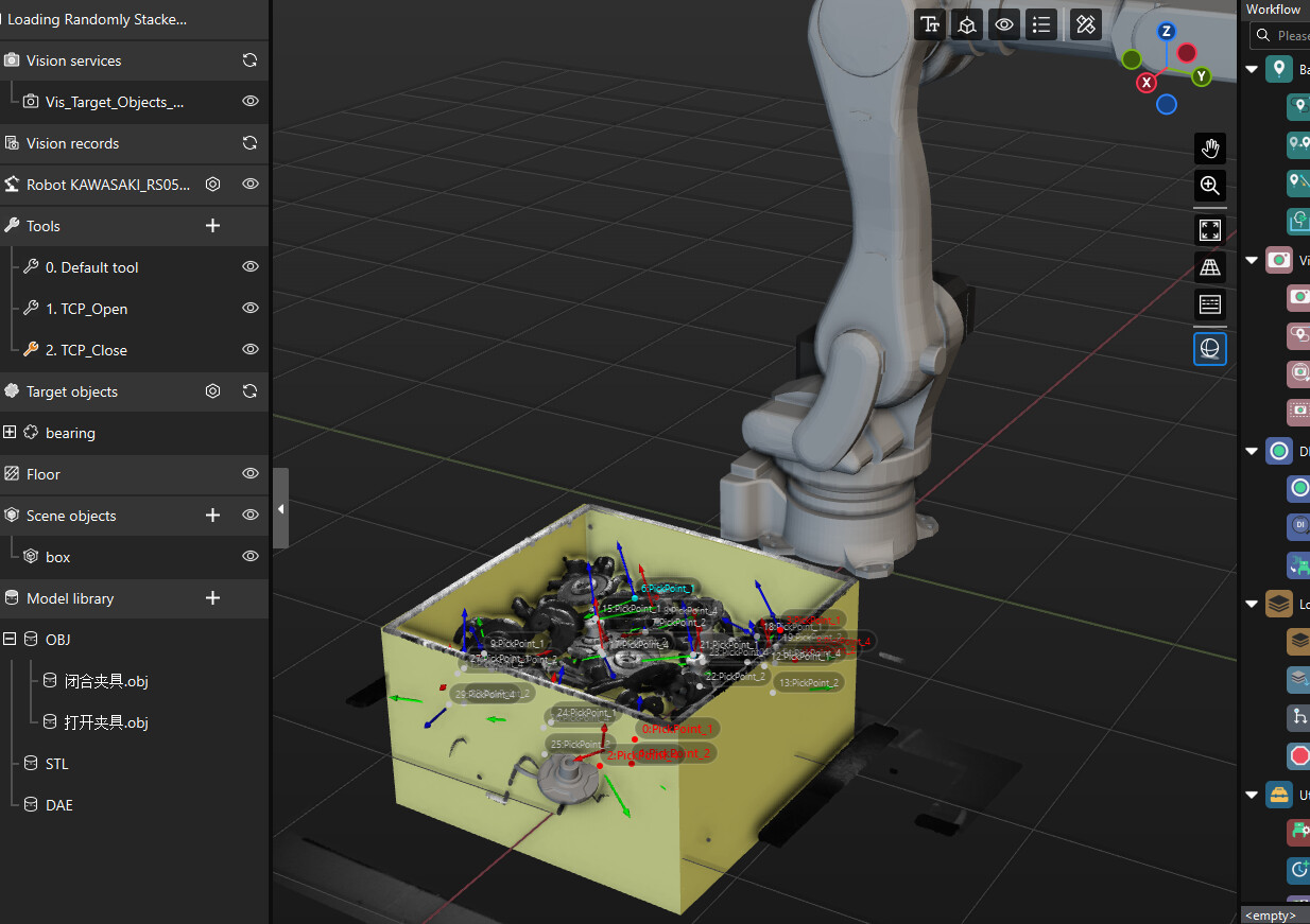

Result
Mech-Viz now receives a properly formed WorkObject containing the pose and starts without errors.
