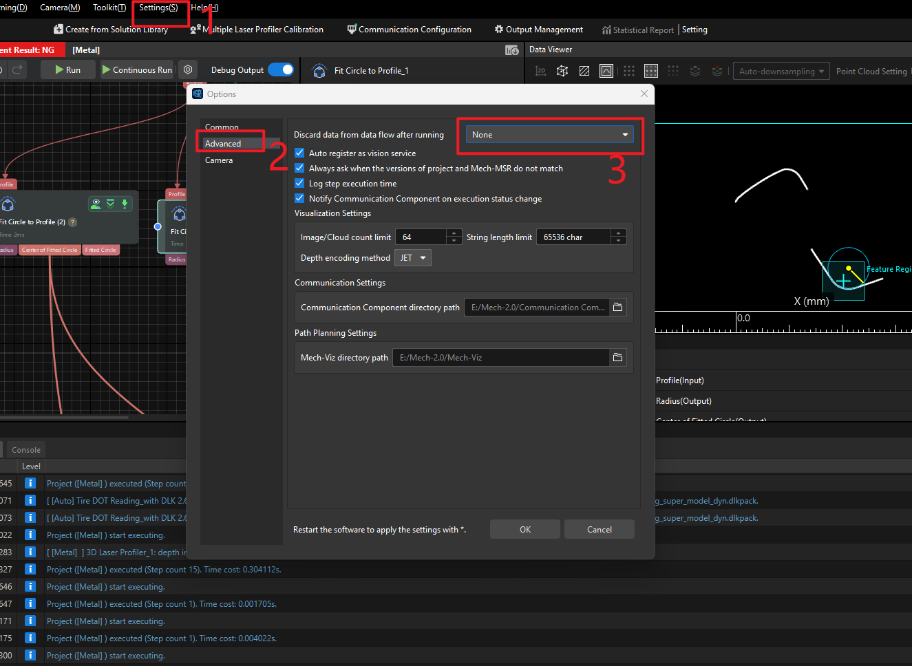

- Go to
Settings > Options > Advanced. - Find the option “Discard data from data flow after running”.
- Change it to “None”.
After that, single-step execution works as expected.
