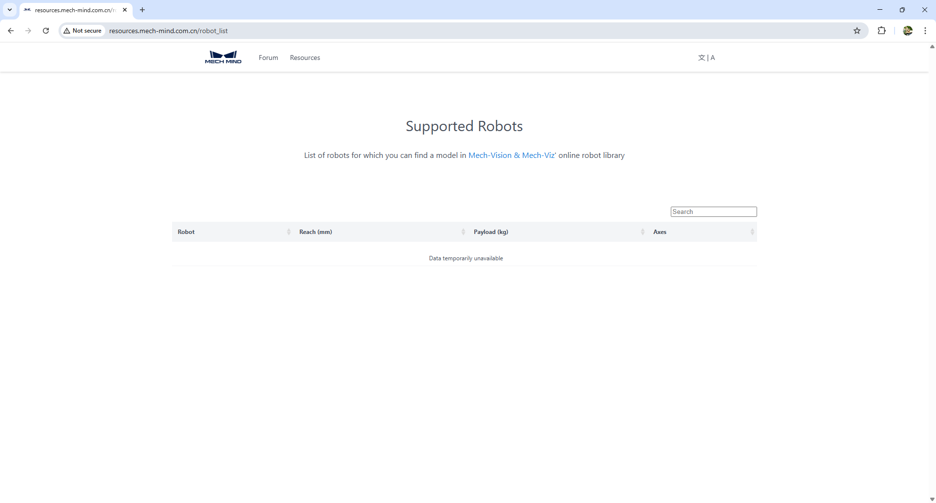

Online Robot Library[Data temporarily unavailable]
Hi Good Day!
I am about to try and connect our robot(Yaskawa HC20DT and Yaskawa MH05) to Mech Vis and Mech Vision but was not able to find it in the list along the software when i installed it. I tried downloading from online library but I cannot connect to it. I also tried accessing it from the web but to no avail.
Your help would be greatly appreciated. Thank You!

We don’t make HC20DT and MH05 in online robot library yet. If you need the robot model, please contact the tech support team.
